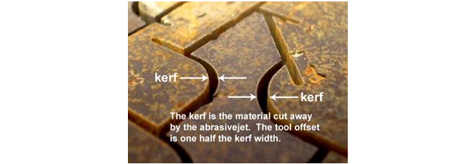

The kerf is the width of the material being removed as the abrasivejet cuts your part.
The Abrasivejet Kerf

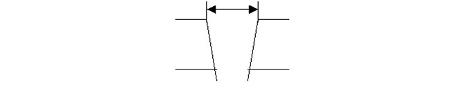

This width can range from 0.021" (0.01 mm) to 0.060" (0.15 mm), depending upon the nozzle, the thickness of the material being cut, and the amount of wear on the mixing tube. The kerf is typically measured at its widest point:

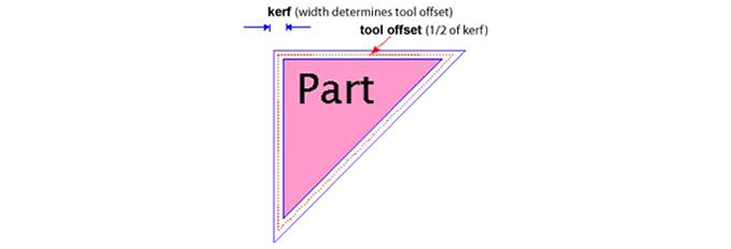

For precise cutting, it is important to know the exact width of the kerf in order to determine the correct tool offset value to be entered when configuring your material setup values.
The Kerf Width and Tool Offset Value
The offset value entered in the material setup screen for the Tool Offset should always be equal to ½ the kerf width. For a kerf width of 0.40” (10.2 mm), the offset entered would be 0.20” (5.1 mm)(1/2 x 0.40). Note: If the offset value entered is too small, then the fatter kerf will cut extra material away from your part. If the offset entered is too large, then the thinner kerf will leave excess material on the part, especially at the lead locations.

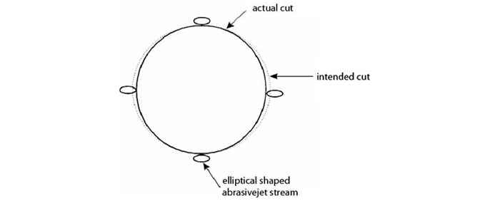

Kerf width will gradually increase as the mixing tube in the abrasivejet nozzle wears. An abrasive jet stream may gradually acquire an elliptical shape, which will cause the tool offset to vary by a few thousandths of an inch (hundredths of a millimeter), depending upon the orientation of the stream shape to the tool path:
Changes in Kerf Width Caused by an Elliptical Abrasivejet Stream
This elliptical shape is usually due to uneven wear in the mixing tube and will tend to increase as your mixing tube wears out. This effect is not a function of the motion control equipment. Rotating your mixing tube 90° on a regular basis allows the mixing tube to wear more evenly and last longer.

You can purposely increase or decrease the tool offset to provide extra material on the part, or to remove more material. For example, if you want to make two mating parts fit together loosely, then reduce the tool offset to have the jet cut more of the material away. Or, if you wish to leave a small amount of material to machine away later, simply increase the tool offset by the desired amount. Remember, a smaller tool offset causes the jet to be CLOSER to the part, thus removing more material. A larger tool offset moves the jet AWAY from the material; thus leaving more material behind.

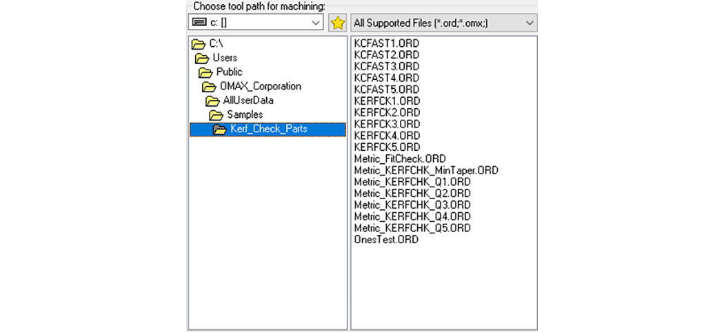

MAKE provides a number of ORD files useful for measuring kerf and evaluating the quality of the abrasivejet stream. These files can be accessed as follows:
1) Open MAKE
2) Click File\Open to view the “Choose tool path for machining” window:
3) Navigate the path C:\Program Files\OMAX Corporation\OMAX_LAYOUT_and_MAKE\Samples\Kerf_Check_Parts to view the list of available kerf check files.

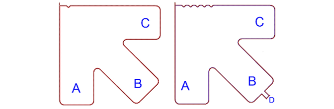

In this list are two sets of files: KCFAST1.ORD through KCFAST5.ORD and KERFCK1.ORD through KERFCK5.ORD. See samples:
The KCFAST1.ORD File----------------------- The KERFCK5.ORD File
These drawings provide three legs, identical in width, that when measured will allow you to determine the accuracy of the cut, the kerf width for a particular quality, and evaluate the status of mixing tube wear. The numbers 1-5 in the file names indicate the quality assigned to that file. In addition to the quality number appearing in the file name, the number of notches cut into the top of the part identify the quality used when looking at the cut part. The two sets of files are identical except for the 0.1" piece sticking out of the bottom of the center leg of the KERFCK set. Measuring this small nub will give you a good idea of how much the kerf width grows when the machine slows down when cutting intricate geometry. Differences in the width of the three legs indicates a worn mixing tube that is producing an elliptical cutting stream. See above illustration in Why Measure Kerf?

Taper of the kerf is controlled by two opposite trends. The jet loses energy as it cuts deeper into the work piece, and thus tends to form a "V"-shaped kerf. On the other hand, the natural shape of the jet is diverging, which tends to form a kerf of opposite shape. The actual kerf shape depends on the jet coherency, and the hardness and thickness of the material. The taper of the kerf is minimized by controlling (usually reducing) the cutting speed to balance these two trends. Sometimes, stand-off distance and mixing tube diameter are also used as controlling factors. In die cutting applications, taper is desirable and is achieved with the same methods.
